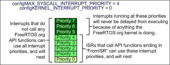

66/* Interrupt nesting behaviour configuration. */
67#define configKERNEL_INTERRUPT_PRIORITY [dependent of processor]
68#define configMAX_SYSCALL_INTERRUPT_PRIORITY [dependent on processor and application]
69#define configMAX_API_CALL_INTERRUPT_PRIORITY [dependent on processor and application]

A full interrupt nesting model is achieved by setting
above (that is, at a higher priority level) than
. This means the FreeRTOS kernel does not completely disable interrupts, even inside critical sections. Further, this is achieved without the disadvantages of a segmented kernel architecture. Note however, certain microcontroller architectures will (in hardware) disable interrupts when a new interrupt is accepted - meaning interrupts are unavoidably disabled for the short period between the hardware accepting the interrupt, and the FreeRTOS code re-enabling interrupts.
Interrupts that do not call API functions can execute at priorities above
and therefore never be delayed by the RTOS kernel execution.
For example, imagine a hypothetical microcontroller that has 8 interrupt priority levels - 0 being the lowest and 7 being the highest (see the special note for ARM Cortex-M3 users at the end of this section). The picture below describes what can and cannot be done at each priority level should the two configuration constants be set to 4 and 0 as shown:
Example interrupt priority configuration
These configuration parameters allow very flexible interrupt handling:
  • Interrupt handling 'tasks' can be written and prioritised as per any other task in the system. These are tasks that are woken by an interrupt. The interrupt service routine (ISR) itself should be written to be as short as it possibly can be - it just grabs the data then wakes the high priority handler task. The ISR then returns directly into the woken handler task - so interrupt processing is contiguous in time just as if it were all done in the ISR itself. The benefit of this is that all interrupts remain enabled while the handler task executes.
  • Ports that implement
    take this further - permitting a fully nested model where interrupts between the RTOS kernel interrupt priority and
    can nest and make applicable API calls. Interrupts with priority above
    are never delayed by the RTOS kernel activity.
  • ISR's running above the maximum syscall priority are never masked out by the RTOS kernel itself, so their responsiveness is not effected by the RTOS kernel functionality.
    This is ideal for interrupts that require very high temporal accuracy - for example interrupts that perform motor commutation. However, such ISR's cannot use the FreeRTOS API functions.
To utilize this scheme your application design must adhere to the following rule: Any interrupt that uses the FreeRTOS API must be set to the same priority as the RTOS kernel (as configured by the
macro), or at or below
for ports that include this functionality.
