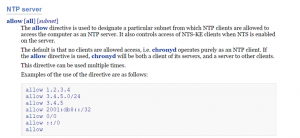

5.1 Update chrony.conf with allow directive
Once
chronyd
is working as an NTP client, it can be upgraded to an NTP server by adding the
allow
directive to the
chrony.conf
file. The
allow
directive allows specifying the network and subnet to accept NTP requests from. Refer to https://chrony.tuxfamily.org/doc/devel/chrony.conf.htmlexternal_link for more information.
NTP server allow directive Click to enlarge
1echo 'allow 0/0' >> /etc/chrony/chrony.conf
2
