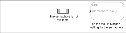

Think of a binary semaphore as a queue that can only hold one item. The queue can therefore only be empty or full (hence binary). Tasks and interrupts using the queue don't care what the queue holds - they only want to know if the queue is empty or full. This mechanism can be exploited to synchronise (for example) a task with an interrupt.
Consider the case where a task is used to service a peripheral. Polling the peripheral would be wasteful of CPU resources, and prevent other tasks from executing. It is therefore preferable that the task spends most of its time in the Blocked state (allowing other tasks to execute) and only execute itself when there is actually something for it to do. This is achieved using a binary semaphore by having the task Block while attempting to 'take' the semaphore. An interrupt routine is then written for the peripheral that just 'gives' the semaphore when the peripheral requires servicing. The task always 'takes' the semaphore (reads from the queue to make the queue empty), but never 'gives' it. The interrupt always 'gives' the semaphore (writes to the queue to make it full) but never takes it. The source code provided on the xSemaphoreGiveFromISR() documentation page should make this clearer. Also see RTOS task notifications, which can be used as a faster and lighter weight binary semaphore alternaitve in some situations.

Using a semaphore to synchronise a task with an interrupt. The interrupt only ever 'gives' the semaphore, while the task only ever 'takes' the semaphore.
